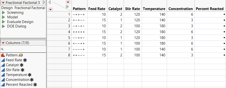

In the Screening Design platform, use the Make Table option to create a data table that contains the runs for your experiment. In the table, the high and low values that you specified appear for each run.
Figure 10.14 The Design Data Table
The name of the table is the design type that generated it.
The design table includes the following scripts:
Screening
Runs the DOE > Classical > Two Level Screening > Fit Two Level Screening platform. Only provided when all factors are at two levels.
Model
Runs the Analyze > Fit Model platform.
Evaluate Design
Runs the DOE > Design Diagnostics > Evaluate Design platform.
DOE Dialog
Re-creates the Screening Design window that you used to generate the design table. The script also contains the random seed used to generate your design.
Run the Screening or Model scripts to analyze the data.
If the design was selected from the Design List, the design table contains a Pattern column. The Pattern column contains entries that summarize the run in the given row. Low settings are denoted by “–”, high settings by “+”, and center points by “0”. Pattern can be useful as a label variable in plots.
