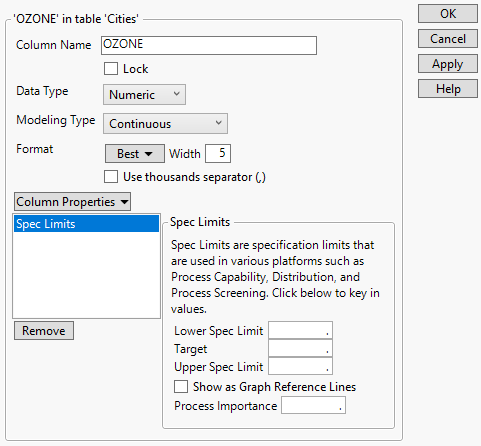

Figure 9.10 displays the Spec Limits section of the Column Properties window for OZONE in the sample data table Cities.jmp.
Figure 9.10 Spec Limits Section of the Column Properties Window
