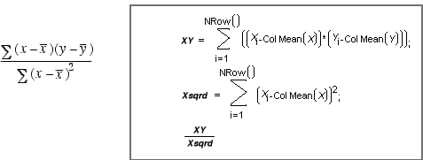

Suppose you want to compute the slope in a simple linear regression of y on x using the standard formula shown in Figure 7.21. One way to do this is to create two local variables, and name them XY and Xsqrd. (See Use Local Variables in Formulas.) Then assign them to the numerator and the denominator calculations of the slope formula. Delimit each assignment with a semicolon, as shown in Figure 7.21. (Statements in the Formula Editor are actually JSL programming statements. Multiple statements in a formula must be separated by a semicolons.) The slope computation is simplified to XY divided by Xsqrd.
Figure 7.21 Local Variables in a Standard Slope Formula
