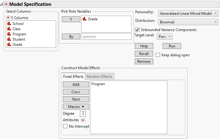

5. Select Program and click Add on the Fixed Effects tab.
Figure 9.2 Completed Fit Model Launch Window Showing Fixed Effects

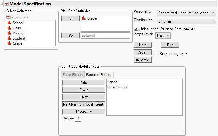

6. Select the Random Effects tab.
7. Select School and Class and click Add.
8. Select School from the Select Columns list, select Class from the Random Effects tab, and then click Nest.

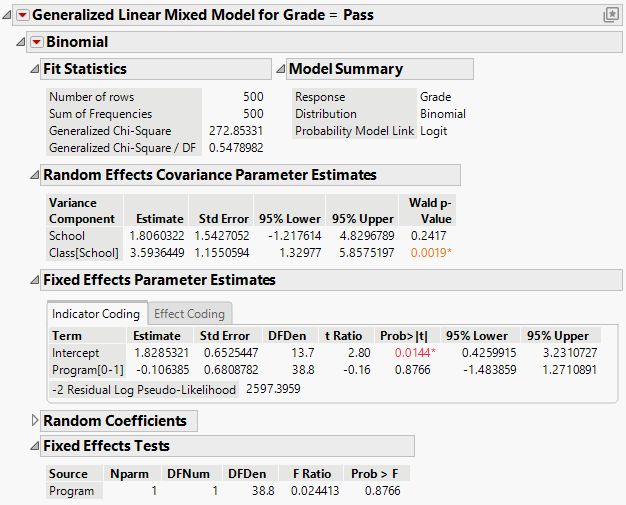

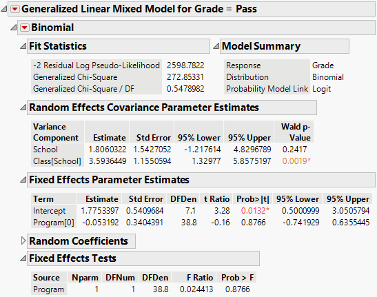

The Generalized Linear Mixed Model report is shown in Figure 9.4. The effect of the teaching program is not statistically significant. However, the class effect nested within school is statistically significant.
