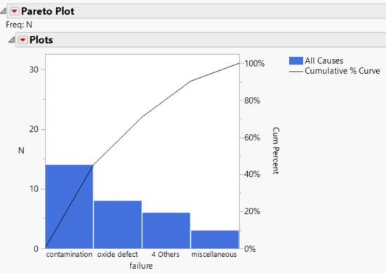

Figure 15.7 Pareto Plot with a Threshold Count of 2
Figure 15.7 displays the plot after specifying a count of 2. All causes with counts 2 or fewer are combined into the bar labeled 4 Others.

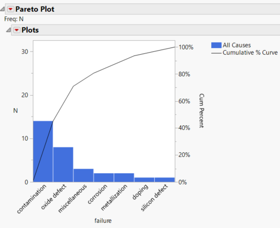

Figure 15.8 Pareto Plot with Separated Causes
