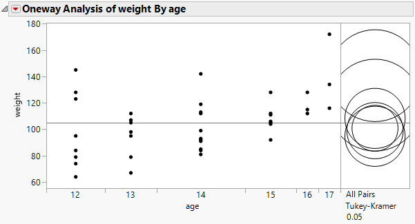

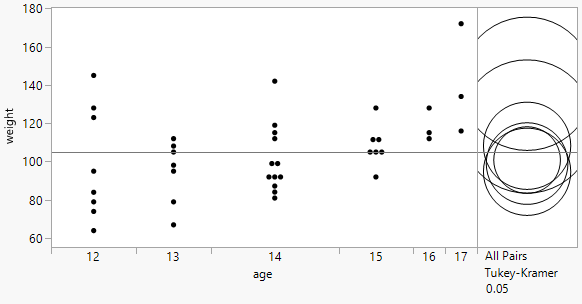

6. Click the Oneway Analysis red triangle menu and select Compare Means > All Pairs, Tukey HSD.
Figure 6.15 All Pairs, Tukey HSD Comparison Circles

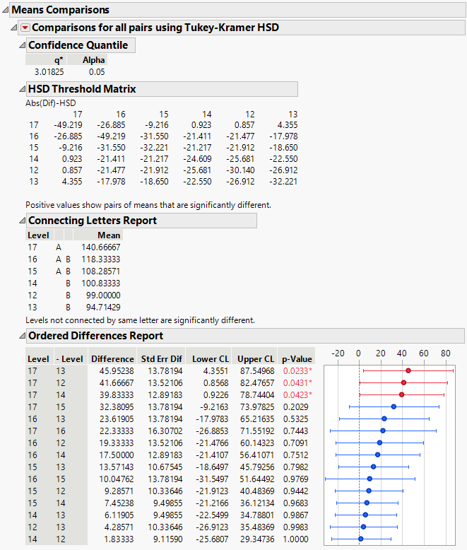

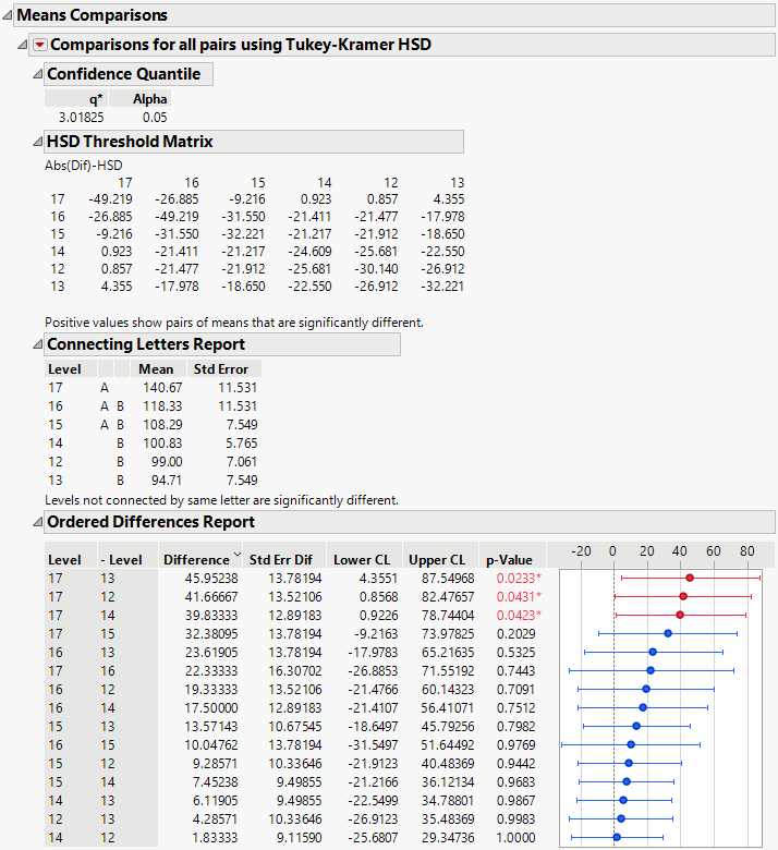

Figure 6.16 Means Comparisons Report for All Pairs, Tukey HSD
In Figure 6.16, the Tukey-Kramer HSD Threshold matrix shows the actual absolute difference in the means minus the HSD. Pairs with a positive value are statistically significantly different at the specified alpha significance level. The q* value in the confidence quantile table represents the quantile that is used to scale the HSDs. It has a computational role comparable to the quantile in a Student’s t test.
