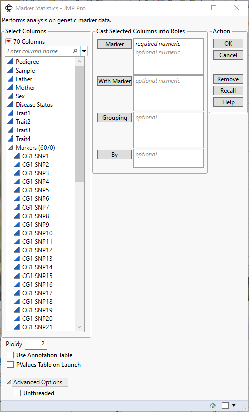

To calculate the marker statistics for your experimental data, launch the Marker Statistics platform by selecting Analyze > Genetics > Marker Statistics.
Figure 3.3 The Marker Statistics Launch Window
For information about the options in the Select Columns red triangle menu, see Column Filter Menu in Using JMP.
Marker
Select desired marker columns and click Marker to specify the markers that you want to analyze.
With Marker
Select desired marker columns and click With Marker to specify the markers to use in pairwise linkage disequilibrium comparisons with the markers specified in X, Marker above.
Grouping
Analyzes the rows assigned to each level of the specified column separately. All results are presented in a single table and report.
By
Ploidy
Enables you to specify the ploidy level of the experimental organism under investigation.
Use Annotation Table
Enables you to access annotation information contained in a separate data table. After you click OK, a window appears, prompting you to specify the name and location of the annotation table.
PValues Table on Launch
Creates a data table for the p-values of the associated estimated marker statistics. This data table is linked to the Result Table in the Marker Statistics report.
Unthreaded
Suppresses multithreading. Deselect this option for improved computational speed.
