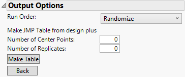

Output Options
In the Screening Design platform, specify details for the output data table in the Output Options section. When you have finished, click Make Table to construct the data table for the design. Figure 10.13 shows the Output Options section for a standard design selected from the Design List. For a main effects screening design, only Run Order is available.
Figure 10.13 Select the Output Options

Run Order
The Run Order options determine the order of the runs in the design table.
Keep the Same
Rows in the design table are in the same order as in the Coded Design or Design sections.
Sort Left to Right
Columns in the design table are sorted from left to right.
Randomize
Rows in the design table are in random order.
Sort Right to Left
Columns in the design table are sorted from right to left.
Randomize within Blocks
Rows in the design table are in random order within the blocks. (Not available if you select Construct a main effects screening design.)
Center Points and Replicates
Number of Center Points
Specifies how many additional runs to add as center points to the design. A center point is a run where every continuous factor is set at the center of the factor’s range. This option is not available if you select Construct a main effects screening design.
Suppose that your design includes both continuous and categorical factors. If you request center points in the Output Options panel, the center points are distributed as follows:
1. The settings for the categorical factors are ordered using the value ordering specified in the Factors section.
2. One center point is assigned to each combination of the settings of the categorical factors in order, and this is repeated, until all center points are assigned.
Number of Replicates
For designs in the Design List, specify the number of times to replicate the entire design, including center points. One replicate doubles the number of runs. This option is not available if you select Construct a main effects screening design.
Note: If you request center points or replicates and click Make Table repeatedly, these actions are applied to the most recently constructed design table.
