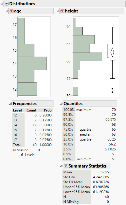

The initial Distribution report contains a histogram and reports for each variable.
Figure 3.5 The Initial Distribution Report Window
Note: Follow the instructions in Example of the Distribution Platform to produce the report shown in Figure 3.5.
