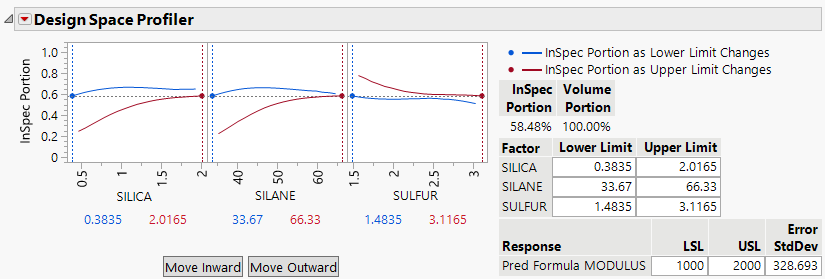

Figure 3.40 Initial Design Space Profiler Report
The initial Design Space Profiler report shows a profiler graph for each factor and several tables. With the factors unconstrained over their full ranges, the InSpec Portion is 58.48%. This means that without defining an operating range, the factors predict responses that fall between 1000 and 2000 about 58% of the time. Now explore setting operating limits on the factors.

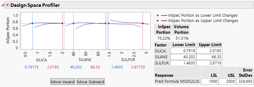

Figure 3.41 Updated Design Space Profiler
The updated Design Space Profiler report shows that setting operating limits improves the InSpec Portion to about 75%. The factor SULFUR keeps a relatively wide range, with only it’s USL moving slightly inward. The other factors, SILICA and SILANE, keep their USLs at their respective maximums while their LSLs moved inward.

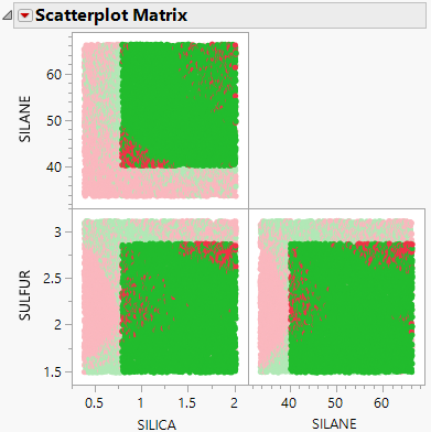

12. In the new data table, click the green triangle next to the Scatterplot Matrix X script to view the setting combinations that lead to in-spec material.
Figure 3.42 Scatterplot Matrix Highlighting Desirable Operating Space
The scatterplots provide a visual representation of the operating limits and their impact on the in spec results. Predicted responses that are within the specification limits are colored green and predicted responses that are outside of the specification limits are colored red. The selected points contain factors at values that are within the operating limits.
