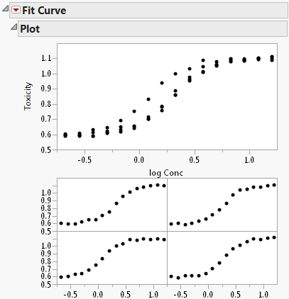

Figure 14.2 Initial Fit Curve Report

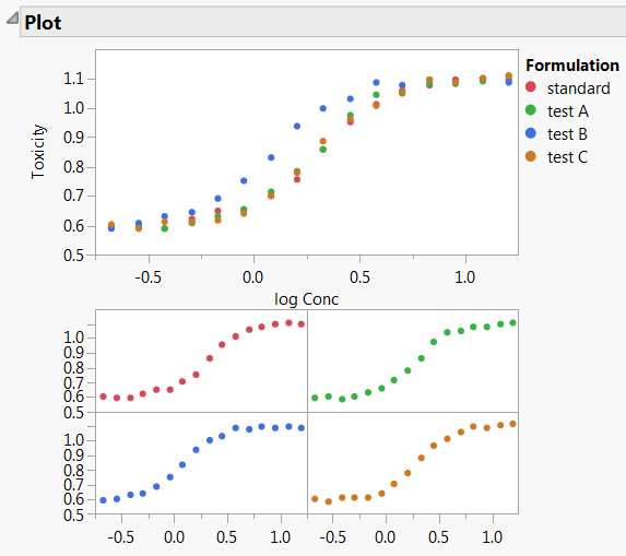

The Plot report contains an overlaid plot of the fitted model of each formulation.
7. To see a legend identifying each drug formulation, right-click one of the graphs and select Row Legend. Select Formulation for the column and click OK.
Figure 14.3 Fit Curve Report with Plot Legend

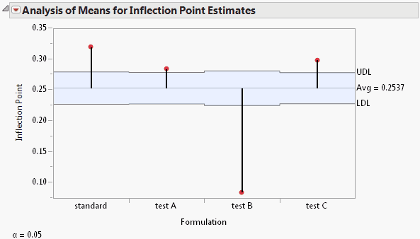

9. Click the Logistic 4P red triangle and select Compare Parameter Estimates.
Figure 14.5 Parameter Comparison Report
Notice that the Inflection Point parameter for the test B formulation is significantly lower than the average inflection point. This agrees with the plots shown in Figure 14.4. Drug formulation B has a higher toxicity ratio than the other formulations.
