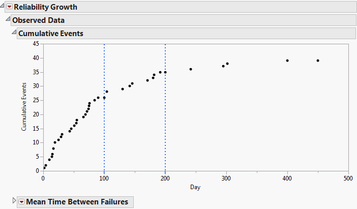

The Reliability Growth report appears. The Cumulative Events plot shows the cumulative number of failures by day. Vertical dashed blue lines show the two transitions between the three phases.

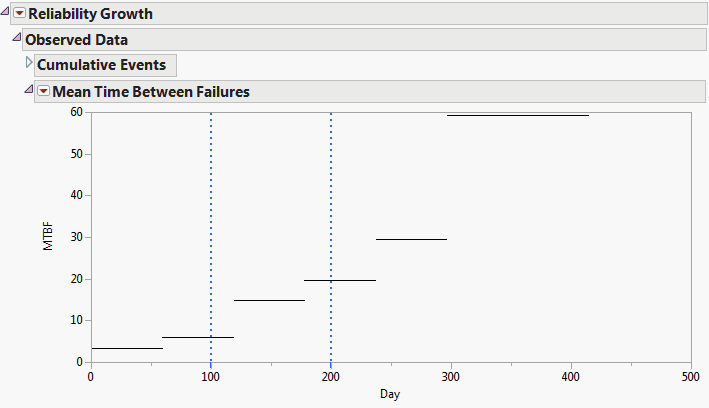

7. Click the Mean Time Between Failures disclosure icon.
This provides a plot with horizontal lines at the mean times between failures computed over intervals of a predetermined size. An option in the red triangle menu enables you to specify the interval size.

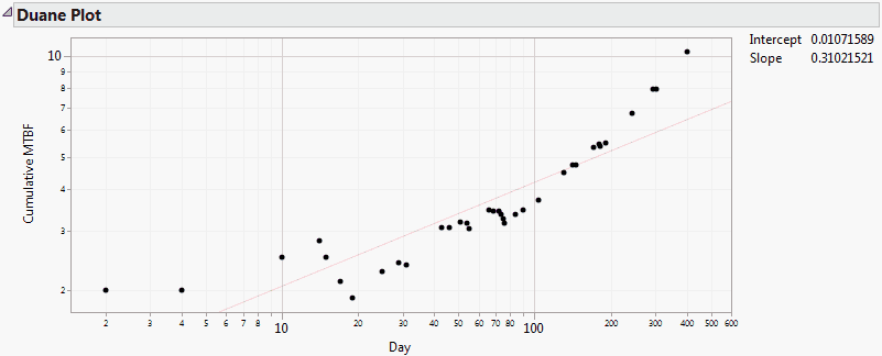

8. Click the Duane Plot disclosure icon.
This provides a plot that displays the Cumulative MTBF estimates on the vertical axis versus the time to event variable on the horizontal axis. If the data follow the Crow-AMSAA model, the points should fall along a line when plotted on log-log paper.

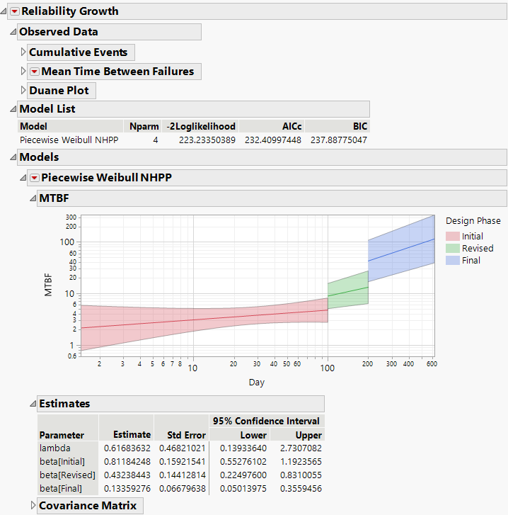

9. Click the Reliability Growth red triangle and select Fit Model > Piecewise Weibull NHPP.
This fits Weibull NHPP models to the three phases of the testing program, treating these phases as multiple stages of a single reliability growth program (Figure 11.5). Options in the Piecewise Weibull NHPP red triangle menu provide various other plots and reports.
