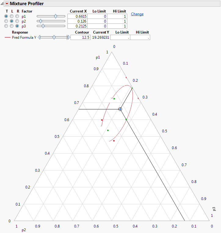

Explore Factor Effects Using Ternary Plots
The Mixture Profiler displays response contours on a ternary plot for mixture models, where three or more factors in the model are components (ingredients) in a mixture. The Mixture Profiler is useful for visualizing and optimizing response surfaces resulting from mixture experiments.
Figure 6.1 Mixture Profiler Example
