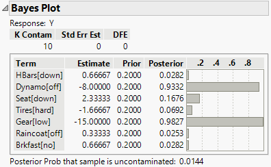

The specifications window, showing default settings for a Bayes Plot for the Bicycle.jmp sample data table, is shown in Figure 3.30. Clicking Go in this window updates the report to show Posterior probabilities for each of the terms and a bar chart (Figure 3.30).
Figure 3.30 Bayes Plot Report
Bayes Plot Report
The note beneath the plot in the Bayes Plot report contains the Posterior Prob that the sample is uncontaminated. Posterior Prob is the probability, based on the priors and the data, that there are no active effects whatsoever. The probability is small, 0.0144, indicating that it is likely that there are active effects. The Posterior probability column suggests that at least Dynamo and Gear are active effects.
