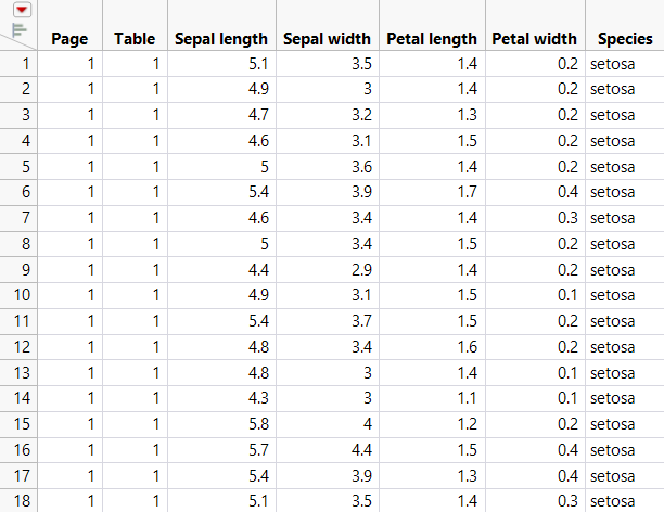

3. In the Table report on the right, make sure that Concatenate tables with matching column names is selected.
4. At the bottom, click OK.
Figure 3.24 Final Data Table (Partial View)
