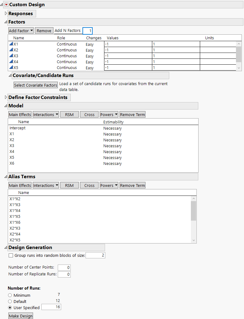

1. Select DOE > Custom Design.
2. Type 6 next to Add N Factors.
3. Click Add Factor > Continuous.
4. Click Continue.
The model includes the main effect terms by default. The default estimability of these terms is Necessary. In the Alias Terms section, notice that second-order interactions are added. By default, all two-way interactions not included in the assumed model are added to the Alias Terms list.
5. Click the Custom Design red triangle and select Optimality Criterion > Make Alias Optimal Design.
The Make Alias Optimal Design selection tells JMP to generate a design that balances reduction in aliasing with D-efficiency. See “Alias Optimality”.
6. Click User Specified and change the number of runs to 16.
Figure 5.9 Factors, Model, Alias Terms, and Number of Runs

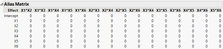

10. Open the Design Evaluation > Alias Matrix section.
Figure 5.10 Alias Matrix
Alias Matrix
All rows contain only zeros, which means that the Intercept and main effect terms are not biased by any two-factor interactions.
