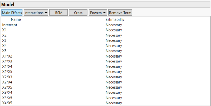

5. In the Model section, select Interactions > 2nd.
Figure 5.6 Model with Interactions
6. Click Minimum to accept 16 for the number of runs.

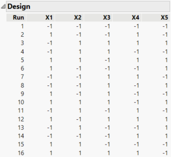

9. Click Make Design.
Figure 5.7 shows the runs of the design. All main effects and two-factor interactions are estimable because their Estimability was designated as Necessary (by default) in the Model section.
Figure 5.7 Design to Estimate All Two-Factor Interactions

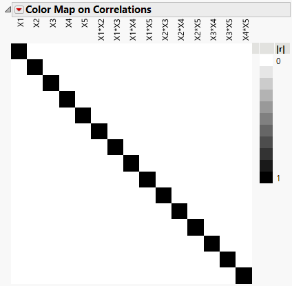

10. Open the Design Evaluation > Color Map on Correlations section.
Figure 5.8 Color Map on Correlations
The Color Map indicates that the five main effects and the ten two-way interactions are all mutually orthogonal.
