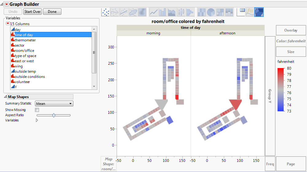

The map shown below is the floor, grouped by time of day. The color reflects the Fahrenheit value. Exploring data visually in this way can give hints as to what factors are affecting office temperature. Looking at this map, it appears the offices on the east side of the building are warmer in the mornings than they are in the afternoons. On the western side of the building, the opposite appears to be true. From this visualization, we might expect that both of these variables are affecting office temperatures, or perhaps that the interaction between these terms is significant. Such visuals help guide decision-making during the analysis.
Figure 12.32 Room/Office Colored by Fahrenheit and Grouped by Time of Day

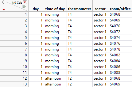

First, data was collected and input into a data table (S4 Temps.jmp). Note the Room/Office column. It contains the unique names for each office and was assigned the Map Role to correctly define the map files.
Figure 12.33 Partial View of the S4 Temps.jmp Data Table

The S4 Temps.jmp data table contains office data over a three-day period. Set up the Map Role column property in the data table:
1. Select Help > Sample Data Folder and open S4 Temps.jmp.
2. Right-click the Room/Office column and select Column Info.
3. Select Column Properties > Map Role.
4. Select Shape Name Use.
5. Click the icon next to Map name data table and browse to the S4-Name.jmp file (located in the JMP Samples/Data folder).
This tells JMP where the data tables containing the map information reside.
6. Select room from the Shape definition column list.
Room is the specific column within the S4-Name.jmp data table that contains the unique names for each office. Notice that the room column has the Shape Name Definition Map Role property assigned, as part of correctly defining the map files.

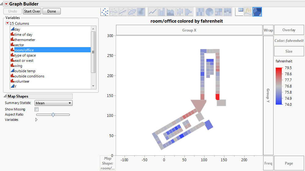

1. Select Graph > Graph Builder.
2. Drag and drop room/office into the Map Shape zone.
Since you have defined the Map Role column property on this column, the map appears.
3. Drag and drop Fahrenheit to the Color zone.
Figure 12.35 Room/Office Colored by Fahrenheit

4. Drag and drop Time of Day onto Group X zone.
Figure 12.36 Room/Office Colored by Fahrenheit and Grouped by Time of Day

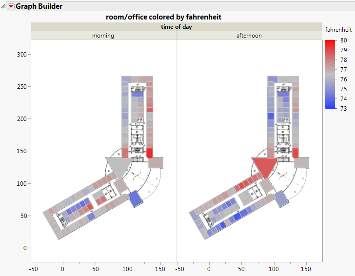

Note that only the offices that were part of the study and were created using the Custom Map Creator add-in are displayed. To add the entire floor plan image, the original floor plan graphic was dragged and dropped onto the Graph Builder window to create Figure 12.37.
To view Figure 12.37, select Help > Sample Data Folder and open S4 Temps.jmp and run the by Time of Day script.
Figure 12.37 Room/Office Map with Original Floor Plan
