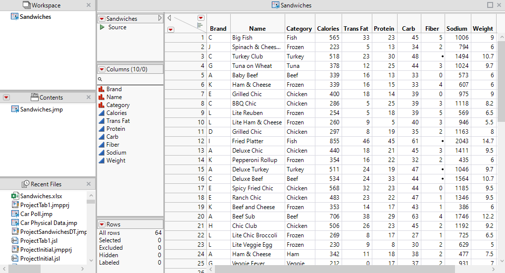

1. Select File > New > Project (Windows) or File > New > New Project (macOS).
2. From the project window, select File > Open.
3. Open the sandwiches.xlsx file, located here by default:
C:\Program Files\JMP\JMP\19\Samples\Import Data
Tip: At the bottom, you might need to change All JMP Files to Excel Files.
4. Click Open.
5. Select File > Save.
6. Make sure Project Contents is selected.
7. Change the file name to Sandwiches.jmp and click Save.
Figure 11.27 Project with Sandwiches Data Imported

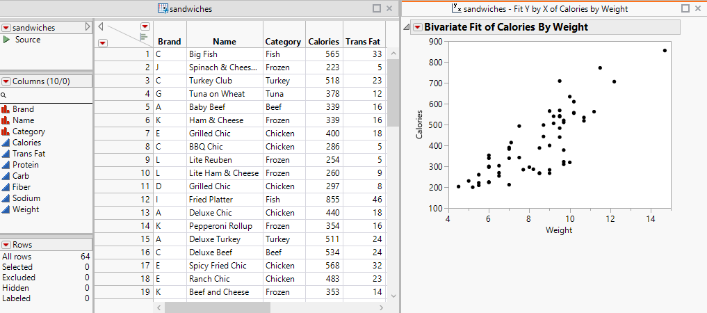

8. Select Analyze > Fit Y by X.
9. Select Calories and click Y, Response.
10. Select Weight and click X, Factor.
11. Click OK.
12. Drag the Sandwiches - Fit Y by X tab to the right and drop it into the Dock right zone.
Tip: To show the entire report, you can drag the line between the data table and the report to the left.
Figure 11.28 Fit Y by X (Bivariate) Report Docked at Right

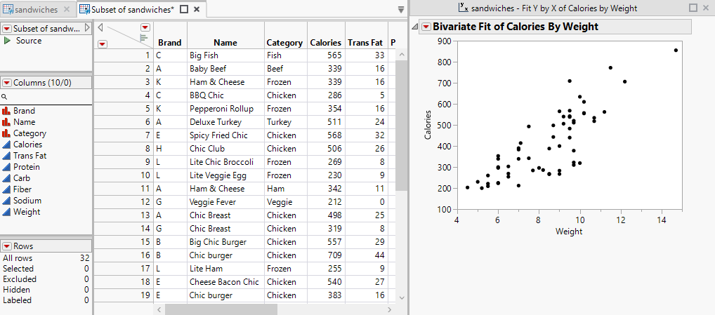

13. Select Tables > Subset.
14. Under Rows, select Random: sampling rate 0.5.
15. Click OK.
Figure 11.29 Project with Unsaved Subset Table
16. Select File > Save Project.
17. Navigate to the folder where you want to save your project, name the project file, and click Save.
18. Close the project.
19. Select File > Open and open your project file.
Tip: At the bottom, you might need to change Excel Files to JMP Projects.
Notice that the subset table that you did not save has been saved automatically to the project file.
