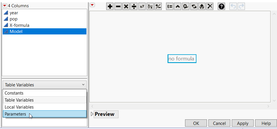

4. Select Parameters from the list below the list of columns.
Figure 15.2 Select Parameters
Select Parameters

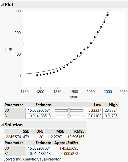

Fit a Nonlinear Model
1. Select Analyze > Specialized Modeling > Nonlinear.
2. Assign Model to the X, Predictor Formula role.
3. Assign pop to the Y, Response role.
4. Click OK.
5. Click Go on the Control Panel to fit the model.
Figure 15.4 Plot and Solution Report
The final parameter estimates are shown in the Solution report, along with other fit statistics. The fitted model is shown on the plot.
