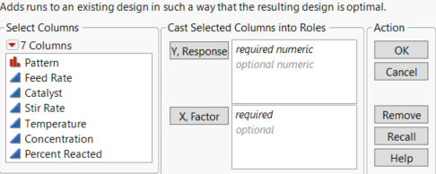

With the data table that contains the design that you want to augment open, launch the Augment Design platform by selecting DOE > Augment Design.
Figure 6.9 Augment Design Launch Window
For more information about the options in the Select Columns red triangle menu, see “Column Filter Menu” in Using JMP.
Y, Response
Enter the numeric response column or columns. Entering a response is required.
X, Factor
Enter the factor columns. Factors can be of any data type or modeling type.
