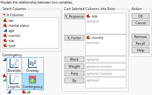

Launch the Contingency platform by selecting Analyze > Fit Y by X. The Fit Y by X launch window is used for four different types of analyses. When you enter an ordinal or nominal Y variable and an ordinal or nominal X variable, the Contingency platform is launched.
Figure 7.3 The Contingency Launch Window
For more information about the options in the Select Columns red triangle menu, see “Column Filter Menu” in Using JMP. The Contingency launch window contains the following options:
Y, Response
The response variable or variables that you want to analyze. These variables must have an ordinal or nominal modeling type.
X, Factor
The predictor variable or variables that you want to analyze. These variables must have an ordinal or nominal modeling type.
Block
A column that specifies a Blocking variable. Specifying a Block variable identifies a second factor and performs a Cochran-Mantel-Haenszel test. Blocking across an additional classification variable is also called stratification.
Weight
A column containing a weight for each observation in the data table. A row is included in the analyses only when its value is greater than zero.
Freq
Assigns a frequency to each row in the analysis. Assigning a frequency is useful when your data are summarized.
By
Data Format
