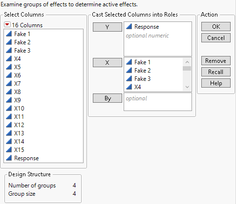

Figure 27.4 Fit Group Orthogonal Supersaturated Launch Window
Y
One or more numeric response variables.
X
Two-level continuous or categorical factors. Because the platform uses the unique structure of a GOSSD in performing the analysis, these factors must define a GOSSD.
