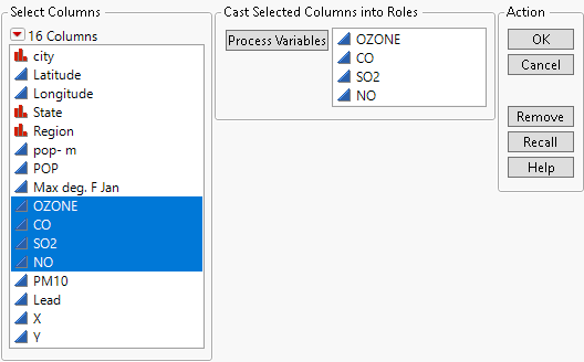

Launch the Manage Limits platform by selecting Analyze > Quality and Process > Manage Limits.
Figure 17.3 Manage Limits Launch Window
For more information about the options in the Select Columns red triangle menu, see “Column Filter Menu” in Using JMP.
Process Variables
The columns of process data containing the measurements. The columns must have a Numeric data type.
