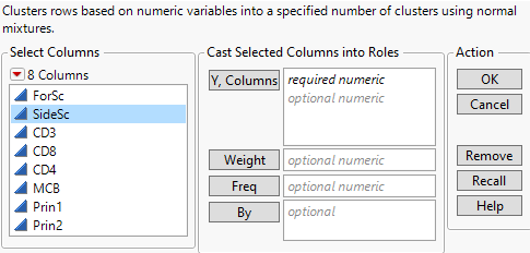

Launch the Normal Mixtures platform by selecting Analyze > Clustering > Normal Mixtures.
Figure 15.4 Normal Mixtures Launch Window
For more information about the options in the Select Columns red triangle menu, see “Column Filter Menu” in Using JMP.
Y, Columns
The variables used for clustering observations.
Note: Normal Mixtures clustering supports only numeric columns.
Weight
A column whose numeric values assign a weight to each row in the analysis.
Freq
By
A column whose levels define separate analyses. For each level of the specified column, the corresponding rows are analyzed. The results are presented in separate reports. If more than one By variable is assigned, a separate analysis is produced for each possible combination of the levels of the By variables.
When you click OK, a Control Panel appears. See Individual Normal Mixtures Report.
