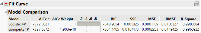

The Model Comparison report in the Fit Curve platform shows fit statistics used for comparing multiple models.
Figure 14.8 Model Comparison Report
AICc
Gives a measure of the goodness of fit of an estimated statistical model that can be used to compare two or more models. AICc is a modification of the AIC adjusted for small samples. AICc can be computed only when the number of data points is at least two greater than the number of parameters. The model with the lowest AICc value is the best, which is the Logistic 4P in Figure 14.8. See “Likelihood, AICc, and BIC” in Fitting Linear Models.

Gives normalized AICc values that sum to one. The AICc weight can be interpreted as the probability that a particular model is the true model given that one of the fitted models is the truth. Therefore, the model with the AICc weight closest to one is the best fit. In Figure 14.8, the Logistic 4P model is clearly the better fit. The AICc weights are calculated using only nonmissing AICc values:
AICcWeight = exp[-0.5(AICc-min(AICc))] / sum(exp[-0.5(AICc-min(AICc))])
where min(AICc) is the smallest AICc value among the fitted models. The AICc Weight column is then sorted in decreasing order.
