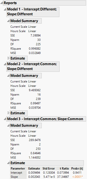

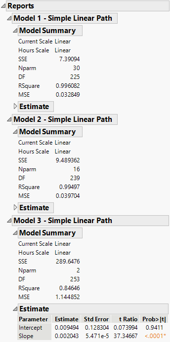

The Reports section of the Degradation Data Analysis report contains details about each model fit. The report includes a Model Summary report, and an Estimate report.
Figure 16.18 Model ReportsĀ
Model Reports
