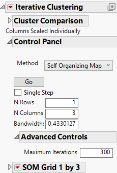

In the K Means Cluster platform, select the Self Organizing Map option from the Method list in the Iterative Clustering Control Panel.
Figure 14.8 Self Organizing Map Option in the Control PanelĀ

N Rows
The number of rows in the cluster grid.
N Columns
The number of columns in the cluster grid.
Bandwidth
Specifies the effect of neighboring clusters for predicting centroids. A smaller bandwidth results in putting more weight on closer clusters.
Advanced Controls
The following advanced controls are available:
Maximum Iterations
The maximum number of iterations of the convergence stage of the EM algorithm.
