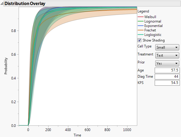

Both the Distribution Overlay and Quantile Function Overlay plots show curves for each of the fitted distributions overlaid on the same graph. By default, each curve has a shaded Wald-based confidence interval. To the right of each plot, there is legend, an option to show shading of confidence intervals, and controls that enable you to specify different values of the effects. Figure 15.6 shows an example of a Distribution Overlay plot.

Figure 15.6 Distribution Overlay Plot
