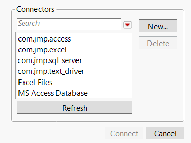

1. Select File > Database > Data Connectors. The Connector box lists data sources that you have established a connection to.
2. Click New Connection.
The Select Data Connector window displays the New Connection dialog.
Figure 3.51 The New Connection Dialog
3. Select a data connector here from the registry of built-in connectors, add-in connectors supplied by your organization, and user-created connectors. Built-in connectors are prefixed with com.jmp, add-in connectors are prefixed with an add-in ID, and user-created connectors have no prefix. New connectors will need to be configured using the configuration options listed in Configure a Data Connector.
4. With a configured data connector selected, click Connect.
The New Connection dialog closes, returning you to the Select Data Connector window.

2. If you are already connected to the database, select it in the Connections box.
The Connectors box lists data sources to which JMP is connected. The Schemas - Tables box lists schemas for those databases that support them.
Figure 3.52 Select Data Connector Window Before Establishing Any Connections
3. If the desired data source is not listed in the Connectors box, click New Connection to choose a data connector. Follow the steps in Configure a Data Connector.
4. Select the desired data source in the Connectors box. The tables list in the Tables box updates accordingly. The update might take several seconds, depending on the number of tables and the speed of the connection to the database. If your database supports schemas, tables are loaded for the first schema in the list, and on other schemas as you click them.

Share a Data Connector Configuration
Configured data connectors can be shared and used by multiple users even on different operating systems by saving the connector as a JMP add-in.
2. Click the red triangle in the Connectors field.
3. Select Share Connectors.
4. Add each connector you want to share from the connector registry to the Selected Connectors field by double-clicking it or selecting it and clicking the > button.
5. Select Save in the Save Add-In File As window.
6. The data connector is saved as a JMP add-in file.
