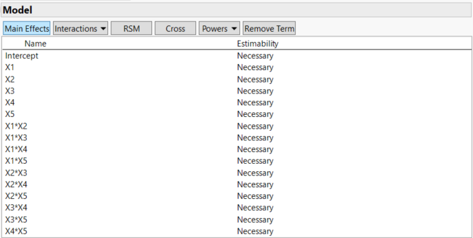

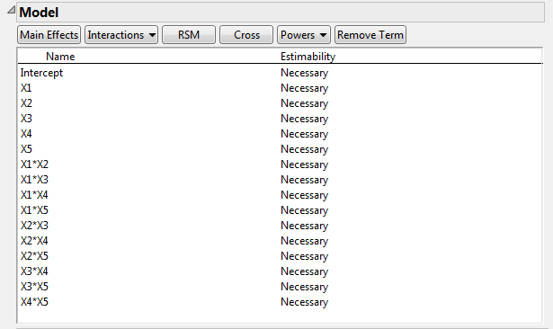

5. In the Model section, select Interactions > 2nd.
Figure 5.6 Model with Interactions

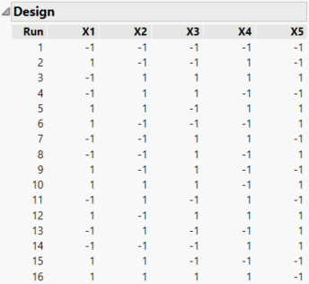

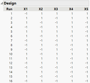

9. Click Make Design.
Figure 5.7 shows the runs of the design. All main effects and two-factor interactions are estimable because their Estimability was designated as Necessary (by default) in the Model section.
Figure 5.7 Design to Estimate All Two-Factor Interactions

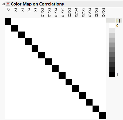

10. Open the Design Evaluation > Color Map on Correlations section.
Figure 5.8 Color Map on Correlations
The Color Map indicates that the five main effects and the ten two-way interactions are all mutually orthogonal.
