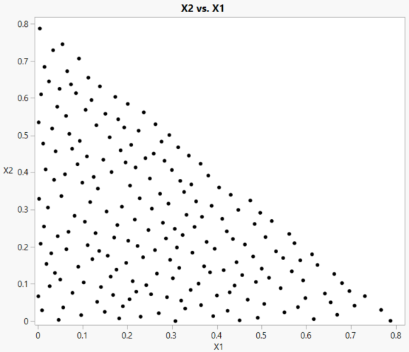

Constructing the Plot
1. With the data table active, select Graph > Graph Builder.
2. Drag X1 to the drop zone labeled X.
3. Drag X2 to the drop zone labeled Y.
4. Remove the Smoother by clicking the smoother icon.
5. Click Done.
Figure 21.16 Fast Flexible Filling Design with One Linear Constraint
Note that the points satisfy the linear constraint X1 + X2 ≤ 0.8.
