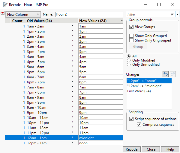

2. Select the Hour column, and then select Cols > Recode.
3. In the Recode window, make these changes:
a. Click the red triangle and select First Word.
Notice that the New Values include only the first hour.
b. Under New Values, click 12am and enter midnight. Click 12pm and enter noon.
Figure 4.6 Completed Recode Window
c. Click Recode.
A new column called Hour 2 is added to the data table.

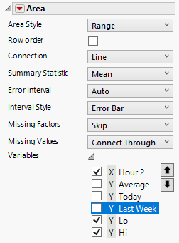

7. Click the Area element Image shown here.
8. In the Area properties panel, make these selections:
a. Change the Area Style to Range.
b. Open Variables and deselect Average, Today, and Last Week.
Now the area element is applied only to the Lo and Hi variables.
Figure 4.7 Completed Area Properties Panel

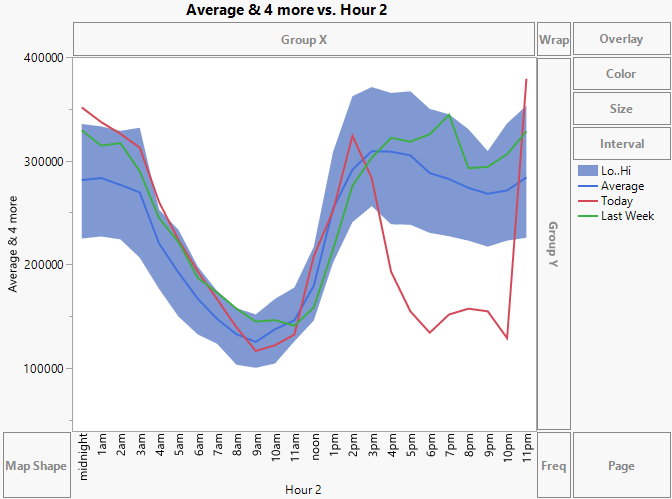

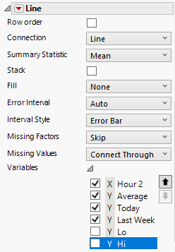

9. Hold down the Shift key and click the Line element Image shown here.
Tip: Holding down the Shift key and clicking adds additional elements to the graph, without replacing any existing elements.
10. In the Line properties panel, open Variables and deselect Lo and Hi.
Now the line element is applied only to the Avg, Today, and Last Week Y variables.
Figure 4.8 Completed Line Properties Panel
Figure 4.9 Area and Line Graphs
