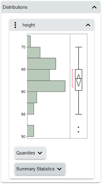

The output appears in your default browser.
Figure 7.8 Interactive HTML Output
For information about exploring interactive HTML output, visit www.jmp.com/interactive. For more information about saving interactive HTML, see Share Reports as Interactive HTML in Using JMP.
