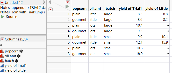

12. Click OK.
Figure 3.28 Joined Table
Joined Table
