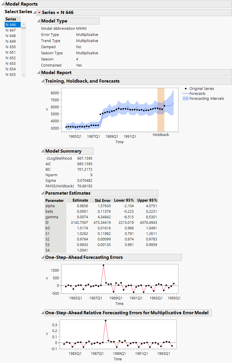

This fits a set of recommended models to the data. The best model for each level of the grouping variable is chosen and reported in the Model Reports. See Model Reports.
Figure 19.3 Model ReportsĀ
Model Reports
The model report for one series, Series N646, is shown. This corresponds to the series name that is selected in the Select Series list. You can use the down arrow key to scan through the model reports for each series. Alternatively, you can click a different name in the list to display the model report for the selected series.
