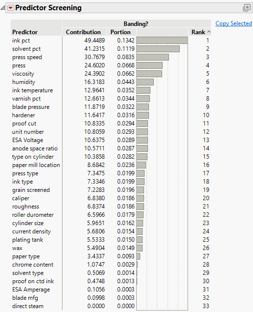

Figure 25.1 Example of a Predictor Screening ReportĀ
