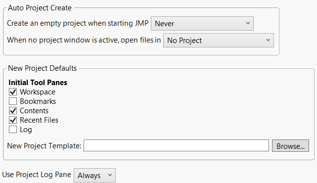

Projects preferences enable you to control how new empty projects are created, which tool windows appear, and more.
Figure 15.8 Projects Preferences
Table 15.7 Preferences on the Projects Page
Preference
Description
Create an empty project when starting JMP
Creates an empty project when you start JMP: Never, Always, or If no other project is open. Never is the default setting.
When no project window is active, open files in
Specifies how a new project is automatically created.
No Project
Does not put the files in a project. This is the default setting.
Open Project or No Project
Puts the files in an open project if found or no project.
Open Project or New Project
Puts the files in an open project if found or a new project.
New Project
Puts the files in a new project.
Initial Tool Panes
Specifies which tool panes initially appear in a project. The Workspace, Contents, and Recent Files tools appear by default.
New Project Template
Specifies the project that you want to use as a template for new projects. The new project has the same window layout, linked documents, graphs, tool windows, and other project elements as the template.
Use Project Log Pane
Specifies when you want to view the project log rather than use the JMP log. Always is the default setting.
