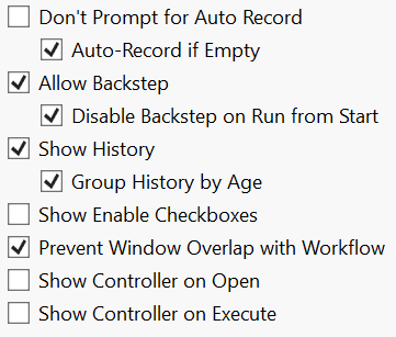

The Workflow Builder preferences allow you to not prompt for auto record, allow for backstep, group log history by age, and prevent other windows from overlapping the Workflow Builder window.
Figure 15.21 Workflow Builder Preferences
Table 15.19 Preferences for the Workflow Builder
Preferences
Description
Don’t Prompt for Auto Record
Specifies whether to prompt for auto recording. This option is deselected by default. If this option is deselected, the Auto-Record if Empty option is selected.
Allow Backstep
Specifies whether to enable the user to back up a step in the workflow. This option is selected by default.
Show History
Specifies whether to show the JMP Log History Panel in the Workflow Builder window. This option is selected by default.
Group History by Age
Specifies whether to group history based on time. This option is selected by default.
Show Enable Checkboxes
Specifies whether to show check boxes on the workflow to enable steps in the workflow. This option is deselected by default.
Prevent Window Overlap with Workflow
Specifies whether to prevent other dialog windows from overlapping the Workflow Builder window. This option is selected by default.
Show Controller on Open
Specifies whether to show the controller for workflow steps in a separate popup window when opening a workflow. This option is deselected by default.
Show Controller on Execute
Select this option to ensure the popup controller is showing any time the forkflow starts executing. This option is deselected by default.
