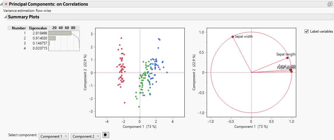

Figure 4.1 Example of Principal Components
