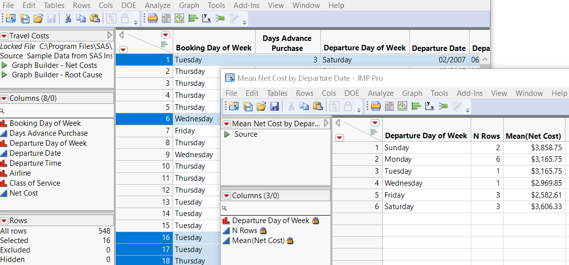

How can you work with dates in JMP? JMP provides a number of formats that you can use to make comparisons and then subset data based on the date.
Select Where Using Dates.jsl applies the Date MDY format to a column of departure dates and subsets the data. A summary table of mean net costs by departure date then appears (Figure 17.2).

Figure 17.2 The Original Table and the Final Summary Table
