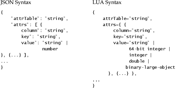

The JSON parameters are specified in the CAS documentation CAS REST API. See https://developer.sas.com/apis/cas/rest/current/apidoc.html. For JSON, you can look at the Lua format and make the appropriate adjustments.
For example, in 图 14.6, notice the difference between the JSON syntax and the Lua syntax. JSON uses the "name" : value format. Lua uses the name = value syntax.
Figure 14.6 Differences Between JSON and LUA
