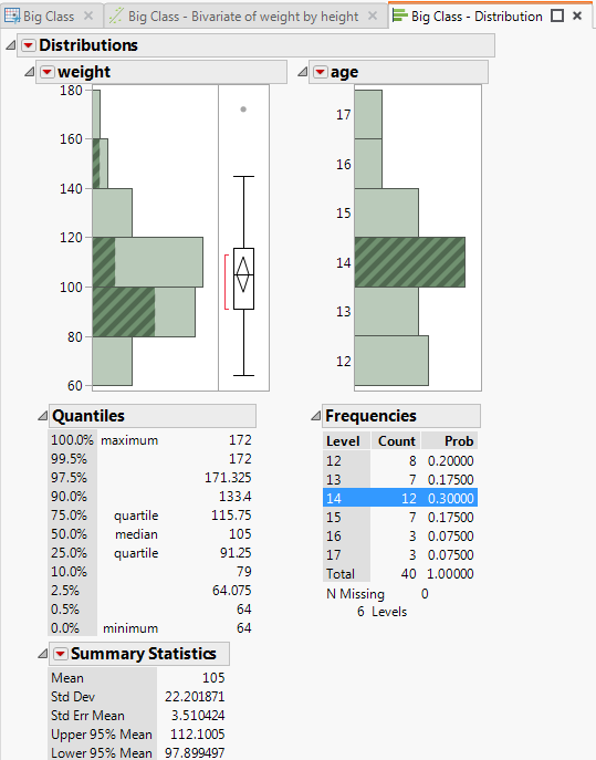

A JMP project provides a way to organize files that you use in an analysis and display the output. A simple project might display the data table, graphs, and reports on separate tabs in the project window.

图 15.1 shows the project with selected bars, showing that the graph is still linked to the data table.
Figure 15.1 Example of a Simple Project
Note: The best way to learn how to write a script for a project is to change the project extension to .zip, open the zip file, and then look for a file called project.jsl in the root directory.
