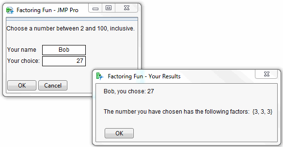

Prime Numbers.jsl asks the user to enter a number and then factors the number or confirms it as a prime number (图 17.5). This script is a good example of aligning several types of display boxes, concatenating text, and working with conditional functions.

Figure 17.5 Factor Numbers Interactively
