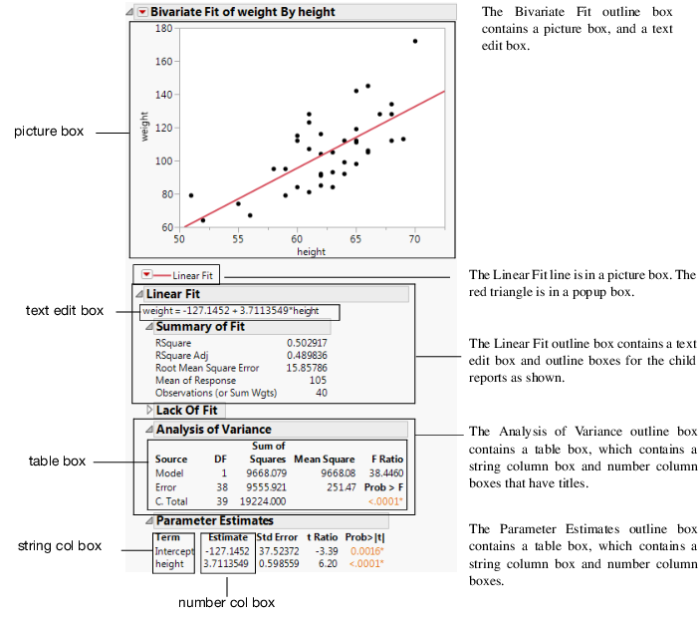

图 11.1
shows a Bivariate report that consists of several common display boxes.
图 11.1
Display Boxes in a Report
Run the following script to create the report:
dt =
Open
"$SAMPLE_DATA/Big Class.jmp"
biv = dt <<
Bivariate
( Y( :weight ), X( :height ), Fit Line() );
