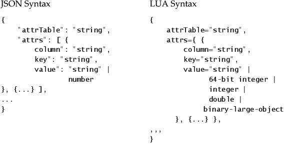

The JSON parameters are specified in the CAS documentation CAS REST API. See https://developer.sas.com/apis/cas/rest/current/apidoc.html. For JSON, you can look at the Lua format and make the appropriate adjustments.
For example, in Differences Between JSON and LUA, notice the difference between the JSON syntax and the Lua syntax. JSON uses the "name" : value format. Lua uses the name = value syntax.
