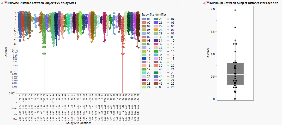

This section presents box plots of the pairwise Euclidian distances between subjects presented by site and Box Plot of the minimum pairwise distance taken from each site.
It contains the following elements:
One set of Box Plots of Pairwise Distances between Subjects vs. Study Sites.
This figure shows box plots of all pairwise Euclidian distances within each study site. Individual points are overlaid with the boxplot. The Y-axis is set to log-scale by default for the ease of identifying small distance points when the range of distance is large. A summary table is shown below the boxplot presenting the N, Mean, Min, Max values for each study site. Values closer to zero (0) reflect subjects that are very similar to one another, which could indicate that they are slightly modified copies.
One Box Plot of Minimum Between-Subject Distances for Each Site.
The box plot of minimum pairwise distances provides some idea of the most similar subjects within each site.

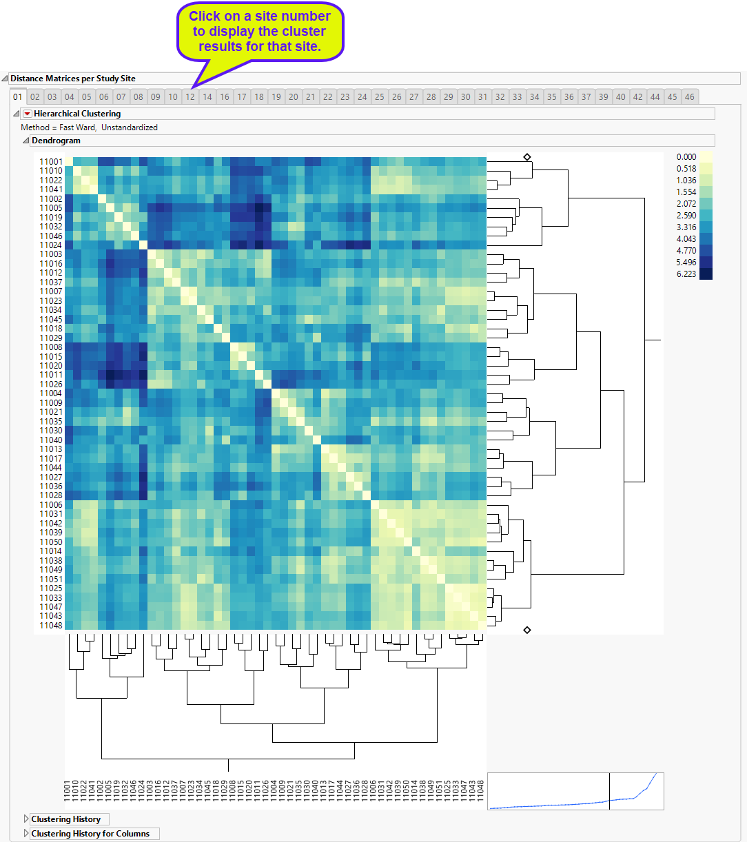

One Hierarchical Clustering display that clusters subjects based on the Euclidean distance. A heatmap from Hierarchical Clustering is shown with subject IDs being rows and columns annotations. The legend shows the pairwise distance values with a minimum of zero.
Bluer color indicates subjects that are more similar, whereas yellow shows subjects less similar. The clustering dendrogram is presented to the right of the heat map and can show sets of more than two subjects that are similar to one another. All the pairwise distance matrices, along with the subjects' ID , study sites and treatment arms, are stored in separate jmp tables, and can be accessed by clicking the 'Show Tables' button.

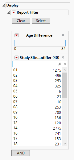

Report Filter
These filters enable you to subset and view subjects based on demographic characteristics (Age Difference), study sites, and other criteria. Refer to Data Filter for more information.

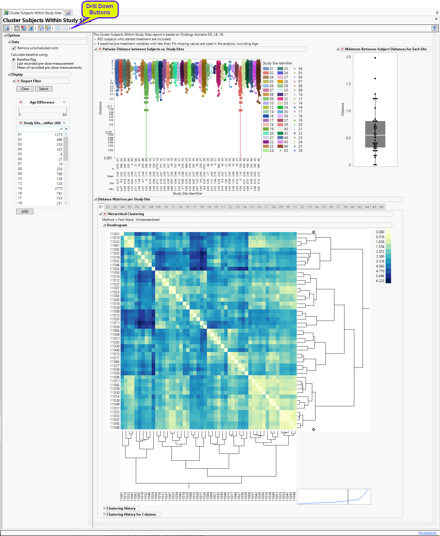

Action buttons, provide you with an easy way to drill down into your data. The following action buttons are generated by this report:
