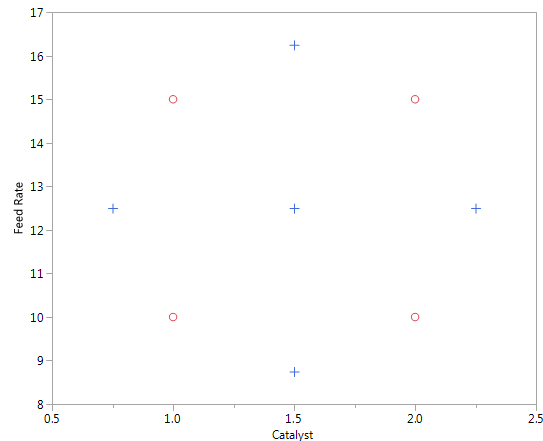

Use the Augment Designs platform to add additional runs to an existing experimental design. Experimentation is often a sequential process and augmenting a designed experiment can help resolve ambiguities that result from a single design.
For an existing design table, the Augment Design platform constructs additional runs that optimize the overall design. You can add runs to accomplish the following objectives:
Replicate the design a specified number of times.
Add center points.
Create a foldover design.
Add axial points together with center points to transform a screening design to a response surface design.
Add space filling points to a design.
Add runs to the design to enable the ability to fit a specific model.
