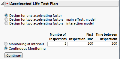

Accelerated Life Test Plan Window
• Specify the Design Structure
Select the model structure and the type of inspection that describe your design.
Initial ALT Design Window
Select one of the first three options to indicate the number of acceleration factors in your design. If you have two factors, indicate whether you want to fit a main effects model or a model that contains an interaction term for the two factors.
Monitoring at Intervals
Assumes that units will be inspected for failures at intervals. Failure times are interval censored. Enter the number of inspections, the time of the first inspection, and a time between inspections. For inspection intervals that are irregular, you can change the inspection times later in the Design Choices outline.
Continuous Monitoring
Assumes that exact failure times are recorded. Failure times beyond the length of the test are right censored.
