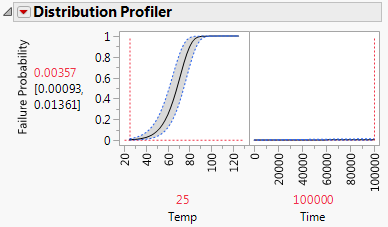

Profiler Showing Failure Probabilities for ALT Experiment
